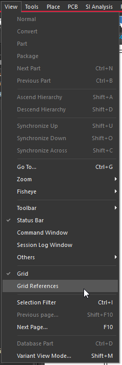

  • taszymanski
    0 taszymanski over 1 year ago
    After much trial and error playing around with values in the ini files, one of my co-workers found a check box (in 22.1) under View called "Grid References"  Unchecking this box and all forms of zooming are back to normal again.  This has proven true in 16.6, 17.4, 22.1 & 24.1.

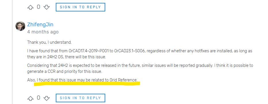

  • Zhifeng Jin
    0 Zhifeng Jin over 1 year ago in reply to taszymanski
    Four months ago,
    when I raised this issue, I had already discovered that unchecking the "Grid Preferences" option could temporarily solve the problem,
    but unfortunately, it wasn't until Microsoft fully released the 24H2 version that anyone cared about it Pensive
