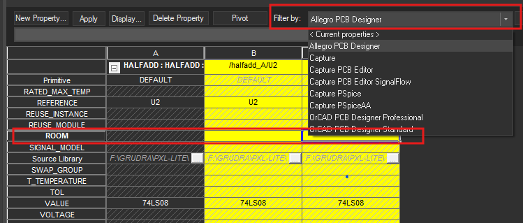

I need to group components in a complex hyerachical design.
How Can I assign a room at occurrence level?
  • rg13
    rg13 11 months ago +1 suggested
    You can enter values for the 'ROOM' property which is available by selecting 'Allegro PCB Designer' filter in the Capture Property Editor . On netlisting the design to the board, Room property shows up…
    'Allegro PCB Designer' filter in the Capture Property Editor. On netlisting the design to the board, Room property
    shows up while placing the part.
