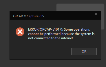

Unable to get online lib parts
Edit slide getting closed
Edit slide getting closed 22 days ago
Current we 23.1 version.
  • ChuckLane
    ChuckLane 22 days ago
    I've seen this too, for the past week to 10 days.
    Doing some packet traces, it looks like Capture is trying to access "pcb.cadence.com", which translates to
    d3kw5v45y2yh8f.cloudfront.net   which does not yield any address.
    So, a Cadence network/DNS type issue.
