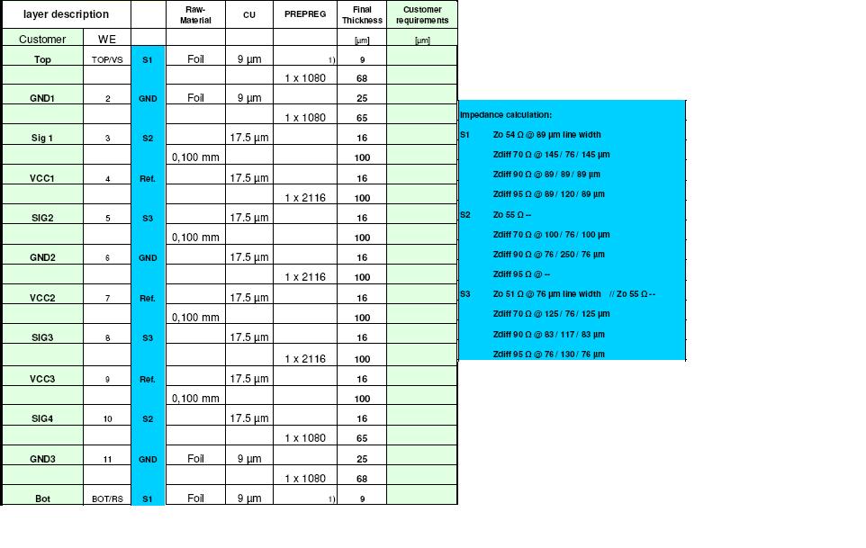

Hi, How the impidence & trace width related . Please find sample stack up data , here if I give the trace width 3mil & spacing 3.5mil in SIG1 & SIG4 layer what will be the trace impidence ? how to claculate this Best Regards, Girish Kumar

    Impedance relates as below:
    1.Inversely proparational to trace width and er.
    2.Directly proparational to height from the reference.
    Satya
