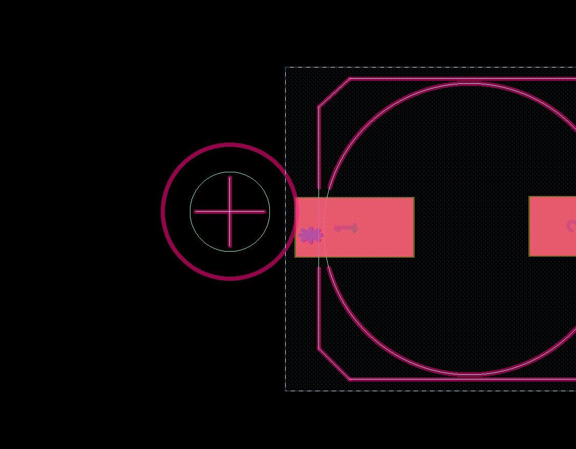

 Does anyone have some SKILL code that will clear silkscreen lines back x distance from pins, either as a group or individually?  I want to use this during footprint building.  Currently I have to use delete and cut to remove pieces of lines that run through pads.

    Surely, when designing the symbol, you don't draw the silkscreen over the pins anyway??

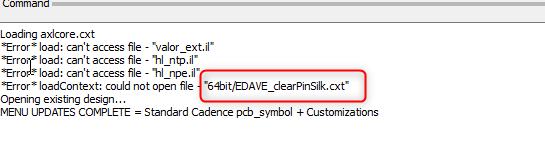

    Thanks for the file, When I run the skill it shows the below Error and there is a path with 64bit    text which is not in the actual path of the context file.
    Command > aline
    radius:11.0
    E- *Error* loadContext: could not open file - "C:/Users/Mypc7894/Desktop/chks/64bit/EDAVE_clearPinSilk.cxt"
    Command >
    Would you please help me to fix this.

  • DE202408202727
    0 DE202408202727 over 7 years ago in reply to dvkumar
    It's a quirk of the 32bit/64bit conflicting requirements that you need to place the cxt file in the 64bit folder.

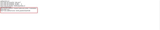

  • GK MN
    0 GK MN over 7 years ago in reply to DE202408202727
    Hello
    I do face same problem , you mentioned place the  cxt in 64bit folder ,i placed it under  C:\Program Files but its showing below error.
    please help me on this . This is a great skill utility using it  from so many years and addicted to it !
  • DE202408202727
    0 DE202408202727 over 7 years ago in reply to GK MN
    You need to put the file in a 64bit folder in your Skill path. So if your site points to c:\mycadence\pcb your cxt file needs to be in c:\mycadence\pcb\64bit
  • GK MN
    0 GK MN over 7 years ago in reply to GK MN
    Thank you very much for reply . But somehow i am unable to make it working  Disappointed .. tried many ways
    below is my setup for skill routine , if you observe anything I am missing please help me to rectify the same, it will be a great help
    17.2 installed under directory  C:\Cadence\SPB_17.2
    PCB ENV file and allegro.ilint located at path :C:\Cadence\DYNAMIC_MENUS\PCBENV
    allegro .ilint updated with command
    load ("EDAVE_clearPinSilk.cxt")
    axlCmdRegister("clear pin silk" 'EDAVE_clearPinSilk ?cmdType "interactive")
    axlCmdRegister("assembly lines to silk" 'EDAVE_assemblyToClearPinSilk ?cmdType "interactive")
    Skill file path  : C:\Cadence\SPB_17.2\share\local\pcb\skill
    Environment variable  : ALLEGRO_PCB_ENV  set to C:\Cadence\DYNAMIC_MENUS\PCBENV
    I kept EDAVE_clearPinSilk.cxt file  at C:\Cadence\SPB_17.2\share\local\pcb\skill
    My all other skill routines working file except this one , i didn't had any issue with version 16.x only with 17.x facing problem
    also error screenshot attached
    Thanks
    Girish Kumar
