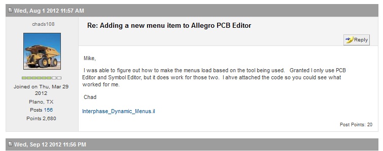

  • girish
    girish over 12 years ago
    Hi Thanks for the reply
    I was looking for Tool based menu load option . Means when I use symbil editor i dont want skill loading which is used for .brd .
    You have posted one modifed .il file  in this thread can you repost it by making it in to zip file .. direct ill file opening showing warning .
    zip file i can download & then extact the skill file
    Girish Kumar

  • chads108
    chads108 over 12 years ago
    Here you go.
    Chad
    Interphase_Dynamic_Menus.zip
