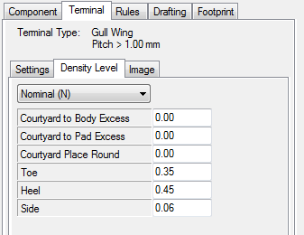

    I also use PCB Libraries for some footprint creation. In the "Terminal > Density" level tab of PCBLE, you can set "Courtyard to ?" to 0 and it makes using DFA simple in PCB Editor. It will generate identical shapes for DFA_BOUND and PLACE_BOUND.
  • Lennie
    Lennie over 9 years ago
    Thanks but tried that and unfortunately the outlines are not the same. The courtyard outline includes the pads.
