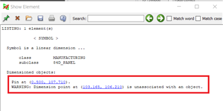

Extract Value from linear dimension show Element .
ENEGUE
ENEGUE over 6 years ago
Anyone know how to get the two coordinate as highlighted in skill?
Thanks,
Eugene

    I not only need the distance but also two coordinate points for the distance.
    Any idea?
    Eugene

    I think the simplest way of getting that data is to use axlShowObjectToFile() to write the data to a ascii file, then parse the file for the coordinate data,
    which I think is easier that attempting to figure out the database pointers from the dimension to the geometry objects
