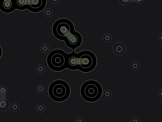

Is there any way to find an resolve issues like this other than visually?
  • RFinley
    RFinley over 6 years ago
    The gap in your dynamic shape?
    But, that is very short in length and cannot radiate.  I'm going to guess, it is on an internal layer and you cover it when you flood the surface layers.

    Lock2002 over 6 years ago in reply to RFinley
    it's not a EMI issue, it's a fabrication issue. I realize it's same net, but I still get grief from my DFM guy and the fab house.

    RFinley over 6 years ago in reply to stumpsr1019
    Well, Allegro has a DRC (reference plane continuity) to catch plane gaps adjacent to traces..
    This is the fight between fab QA and EMC/EE engineers.  Reference plane gaps at some point lead to bit-error rates going up.
    Still don't understand why this is considered an acid trap without an acute angle.
    not an acid trap, just not manufacturable. If they fab as-is the gap will not be there or with such small gaps the resist could come off and cause issues elsewhere. Plus we've beat our fabricators up so much that they are afraid to make any decisions without our approval.

    RFinley over 6 years ago in reply to Lock2002
    My condolences as you could have this dialed in, but fabricators have varying etch aggressiveness as a chemical process.  Add electroplating to this layer and...
    Aerospace?   Usually you have lower risk with a slightly bigger copper gap.    Have to ask, what industry would spend time on this?
