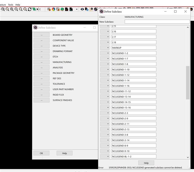

Is it possible to delete unused nclegend subclasses from copied board file?

    Yes, just turn on those layers alone.  Delete anything and everything.  If they are blank then go to the subclass manager and delete from there.  It will tell you if something still resides on a layer that must still be deleted.

    that doesn't work. "ERROR(SPMHDB-393):NCLEGEND generated subclass cannot be deleted.

    Hmmm...can you take a screen shot of your subclasses menu?  All user added can be deleted.  No system subclasses.  There is no system sublcass called NCLEGEND in my tools so I suspect you didn't follow my instructions above.  *Everything* has to be removed from the layer. Make sure nothing is "fixed"

    I'm 100% certain nothing exists on any of the ones I'm trying to delete...

    Are you pulling down the arrow and selecting delete?  There should be no issue with deleting those if they are in fact empty.  The error message should have said "NCLEGEND-1-2" (or one of the ones shown) so maybe you are running a script or SKILL which is looking for a non-existent subclass....

    One idea: nclegend are made of line, text, symbols and are in a group.
    Do delete the group or only line/text?
    Maybe it remmeber a greoup is prsent but with nothing left inside.
    Try delete group and in the entire area.

    I've confirmed that the only remaining groups are the ones in use.
