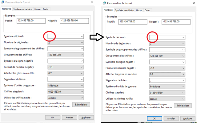

Hello !
I have a big problem when creating a padstack using the Padstack Editor 17.4
In the "drill" tab, I cannot enter any numeric data without having the error message: "Value must be greater than 0"
This problem does not appear in version 17.2  padstack editor
For  SMD pad, I have the same problem in configuring the dimensions.
My Cadence version is up to date
Anyone have a solution?

  • alaphilippe
    alaphilippe over 5 years ago
    Hello everyone.
    Thank you for your help and answers.
    I finally find the solution.
    You have to go to the regional settings of Windows, and indicate the separator "." instead of the separator ","
