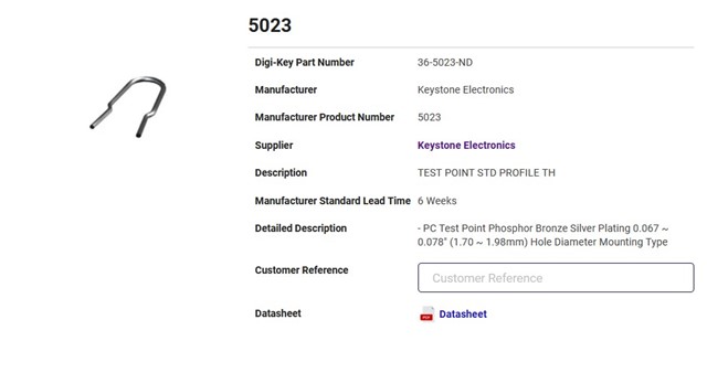

    A test point can be a part, it depends on your definition of what a test point is.  for example:
    https://www.digikey.com/en/products/detail/keystone-electronics/5023/5255493?s=N4IgjCBcpgHAzFUBjKAzAhgGwM4FMAaEAeygG0R5YAWWANlhAF0iAHAFyhAGV2AnAJYA7AOYgAvkQC0EaCFSRMuQiXKU6zcZJAAmNezw5OTcUA
    This part  is called a test point.
    We use Kobicon "test points"
    We use Keystone Test points
    We use unpopulated headers as test points.
    It is all in the definition of what you desire as a test point.
    So if I don't put these components in the schematic, how would I show them in the BOM, and the 3D assembly drawing?
