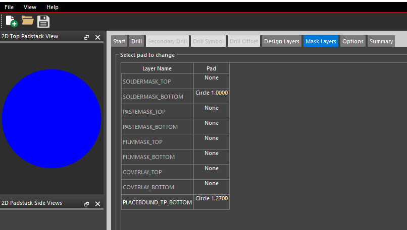

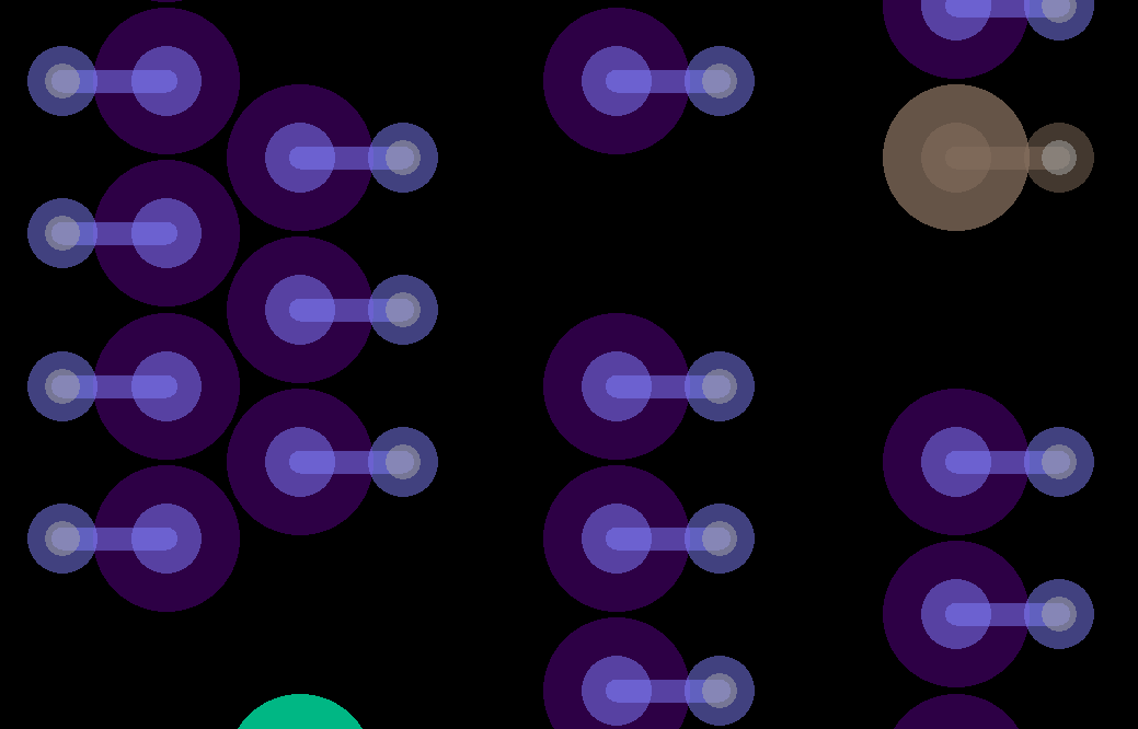

  • SOT23
    0 SOT23 over 4 years ago in reply to jc teyssier
    The goal is to avoid placing TPs to close to one another. I think it is nice to have a visual reference that the 2 TP you just placed are less than 1.27mm apart (or any other distance).
    In this picture I added a custom layer to the TP so that it displays some kind of "placebound" (I know it is not actually a placebound), this way, when I place my TP i know directly that there is enough space between them :
    The "fake placebound" is a 1.27mm circle, so that I am sure that there is 1.27mm between 2 TP when these circles are touching.
    What I would like to do is add some kind of constraint to this layer so that it throws a DRC whenever the fake placebounds overlap.
    Here is how I defined it in the padstack editor :
