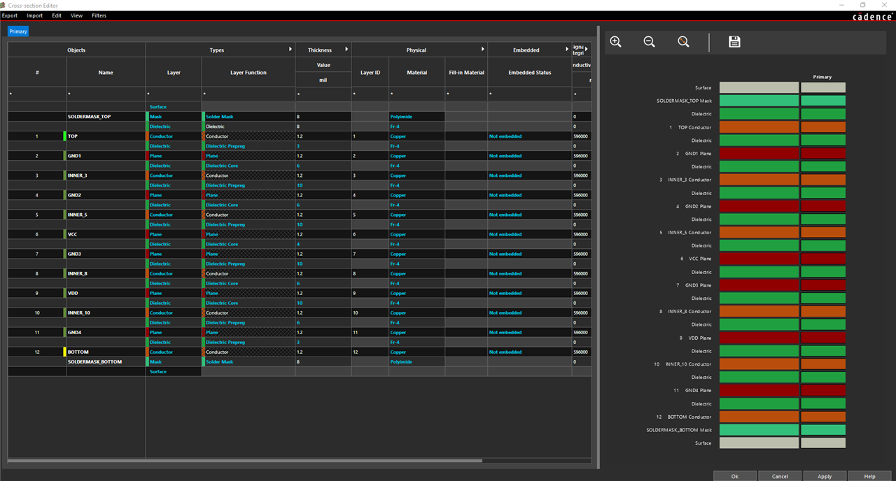

An ideal stackup should be like the stackup shown in the screenshot below:
  • sravan padarthy
    sravan padarthy over 2 years ago
    cant read the text in the stackup image.
  • VVRD
    VVRD over 2 years ago in reply to sravan padarthy
    Hi Sravan,
    It's fixed. Please check.
    Thank you.
  • masamasa
    masamasa over 2 years ago
    hello
    i see the layer function in different colors.
    for instance, the conductor and dielectric are in white whereas othes are in bule.
    why are the layers having the names in different colors?
    I have this on my design.
    i alway wonder what the significance of the color difference is.
    regards
    masa
  • VVRD
    VVRD over 2 years ago in reply to masamasa
    If you change Dielectric type from default, for instance if you change Layer function from Dielectric to Dielectric Prepeg, it changes from white to blue, that means they're altered.
