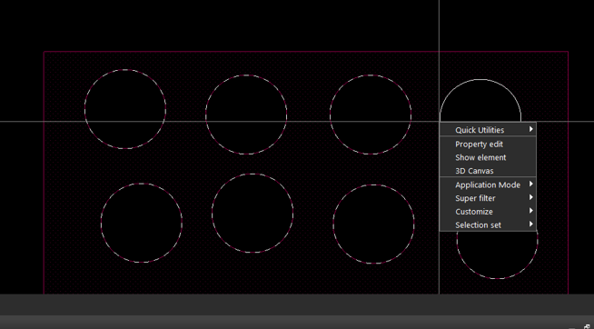

Hi allegro experts!
Can you help me with this. Thanks!
How to expand/contract multiple voids at the same time? is there script needed for this command?
