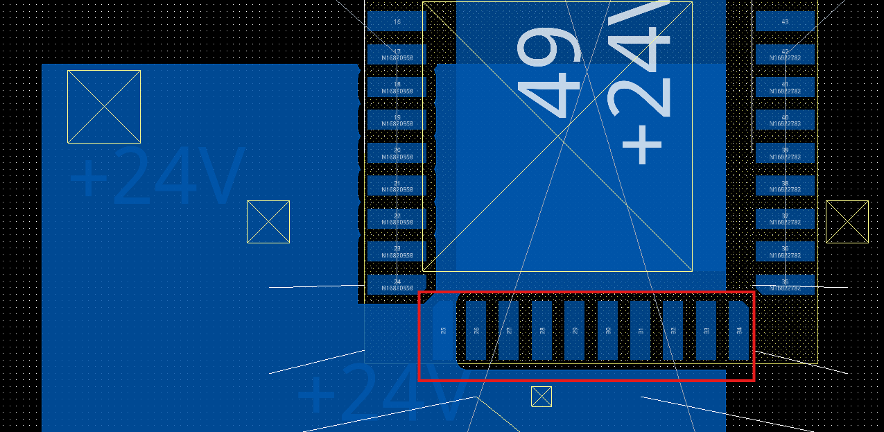

I've assigned a Net Short property to a number of pins (red rectangle) in a symbol, but only one seem to be taking effect. The +24V shape has Thermal relief connects set to Full Contact for Smd pins. What's going on?
Using Allegro X Designer 24.1-2024 S003 [3/6/2025] Windows SPB 64-bit Edition.

    I've been told by the Cadence support that there's an issue with the rectangle pad geometry and the Net Short property. Cadence is investigating it.

    I can't get it to work either Disappointed
    I remember it worked when we added the PIN_SHORT properties in the schematic using Design Entry HDL
