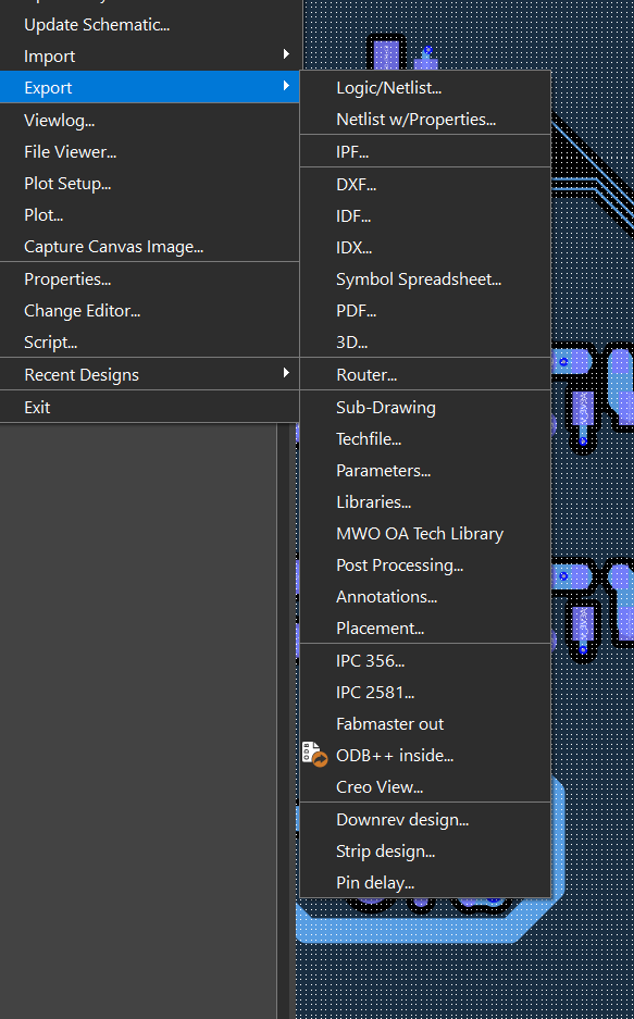

I’ve designed a PCB prototype, but the final version will have a different board size. I've already completed the routing for key components like the CPU and RAM. Is it possible to copy those sections into the new PCB layout to avoid redoing the routing?
  • andakConsultingLtd
    andakConsultingLtd over 1 year ago in reply to EO202501307419 +1 verified
    Try Export->Sub-Drawing, looks like you have a different GUI (it happens due to Licensing and version)

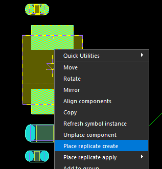

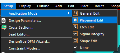

    Yes, it is and you have 2 options:
    1. Use Export->Clipboard feature
    2. Use replicate modules available in Placement Mode
  • EO202501307419
    0 EO202501307419 over 1 year ago in reply to andakConsultingLtd
    Thank you for your reply.
    Regarding the 1st option, there is no clipboard feature in export tab. How can I enable it?
    Regarding your 2nd option, Could you please clarify it?  where can i find replicate modules?
    +1 andakConsultingLtd over 1 year ago in reply to EO202501307419

    On #2 you need a minimum OrCAD professional License to do this (note: it might be different on yourGUI),
    In the original design, enter placement mode:
    This will allow you to select Symbols without being in a command
    Select the group you'd like to replicate and right click on it and select Place Replicate Create
    Select additional items like traces/shapes/vias, right click Done and select origin. Save it as a module when prompted
    In the Destination, enter the placement mode, select the components you'd like to apply this to and right click, selecting Place Replicate Apply and the module name.
    Eventually, break the module by selecting Groups from the filter in place mode, select the group, right click and then Disband Group.
  • avant
    0 avant over 1 year ago
    Use Export / Sub Drawing.
    I export symbols, clines, vias, and any shapes.
    When you import the sub drawing, the symbols will be dummy parts. just use swap/component to swap the dummy parts with the real parts.
    Any copper shapes you import will not have a net assigned. Just select the shape and assign appropriate net.
