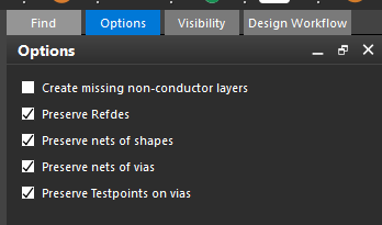

I’ve designed a PCB prototype, but the final version will have a different board size. I've already completed the routing for key components like the CPU and RAM. Is it possible to copy those sections into the new PCB layout to avoid redoing the routing?
  • andakConsultingLtd
    andakConsultingLtd over 1 year ago in reply to EO202501307419 +1 verified
    Try Export->Sub-Drawing, looks like you have a different GUI (it happens due to Licensing and version)
    0 andakConsultingLtd over 1 year ago in reply to avant
    not if you tick a few more options when exporting the subdrawing like shown below:
    0 andakConsultingLtd over 1 year ago in reply to excellon1
    Actually, a schematic can be used within another schematic, as a reference (exactly like in hierarchical designs). This means that you don;t need the workaround of stripping the design and all other tricks. Thus, someone can work on a specific page/module which then can be used in the master design without much effort. This is a great feature when 2 or more people are working on the same project.
    Reuse modules in PCB are also part of this process. I've only seen this (in combination with the above schematic comment) once in 20 years and I don't remember other details. It might be available only in Allegro.
