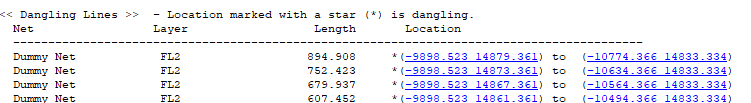

hello:
some report files have the xy locations which have a link to the exact location.
for instance i can click the xy coordinates highlighted in blue and automatically i am pointed into the location.
however, some other report files do not have a locational link.
for instance, there are xy coordinates on the report file without a link to the location as shown below.
is there a way to list up the xy coordinates with a link to the locations on all report files?
regards
masa

    Hi Masa,
    You can refer this code.
    axlCmdRegister("rpt2log" 'rpt2log)

    HoangKhoi

    0 DavidJHutchins over 1 year ago in reply to Hoangkhoipcb
    I updated my code to fail if the file type is not "rpt" & to not process the files that are already written in the 'new' format
    example messages:
    ERROR: file type html not supported with this tool
    Warning: file Net_Single_Pin_and_No_Pin.rpt is already in the new format
    https://community.cadence.com/cfs-file/__key/communityserver-discussions-components-files/28/3857.rpt_5F00_update.zip
