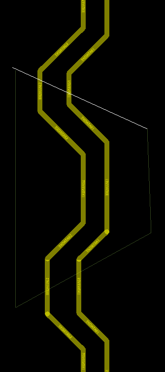

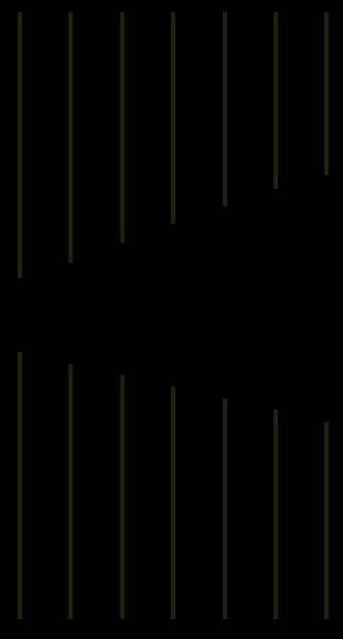

hello
i do know that we can delete some area on clines by the "delete by rectangle" command.
but is there a way to select the cline area by poligon to delete so that the area is not a rectangle but a parallelogram as show below?
regards
masa

  • masamasa
    0 masamasa over 1 year ago in reply to andakConsultingLtd
    thank u for ur response.
    unfortunately the skill code does not work,
    this code deletes clines located outside of the selection area and does not delete clines located inside of the selection area.
    it looks like any clines which are not vertical and horizontal are ignored on this code and any clines on the selected area are deleted by segment.
    regards
    masa

  • excellon1
    0 excellon1 over 1 year ago in reply to masamasa

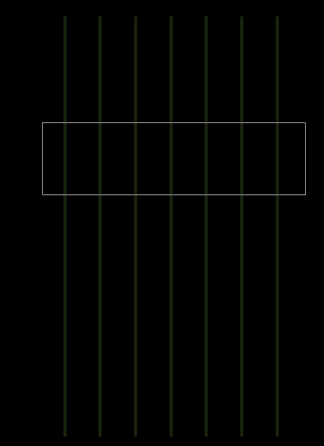

    Hi Masa,
    It is possible to do a delete by rectangle so that segments either inside or outside the area get deleted. This would be a regular rectangle not one that is offset. Have you tried it out ?, seems fairly usable.
    Go to Manufacture > Drafting and choose "Delete by rectangle" , next go to the options panel and select remove within rectangle.
    Next draw a rectangle around your clines so they highlight, then draw the rectangle again to cover the area of those highlighted cline's and
    the area inside the rectangle will get deleted.
    Best regards.

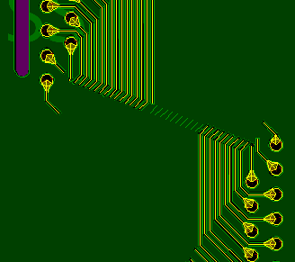

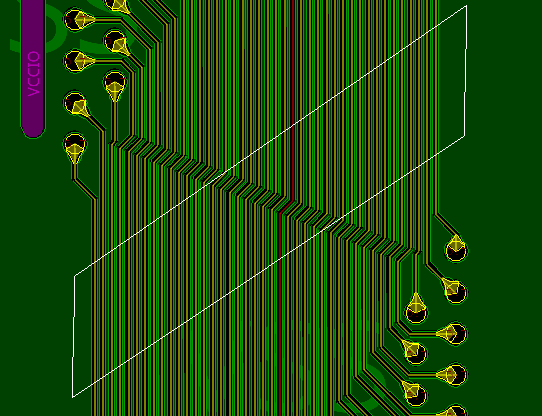

  • masamasa
    0 masamasa over 1 year ago in reply to excellon1
    thank u for ur response,
    i do know how to use the delete by rectangle command but the poligon selection does not work.
    what i would like to know is how to get his below.
    regards
    masa
  • andakConsultingLtd
    0 andakConsultingLtd over 1 year ago in reply to masamasa
    you should be able to write a SKILL around SCALPEL that does the job. SCALPEL cuts the traces at intersect while the vertexes against the closed loop will give you the information of the clines located inside the loop.

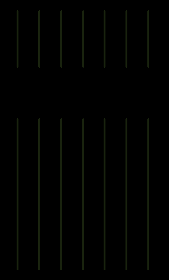

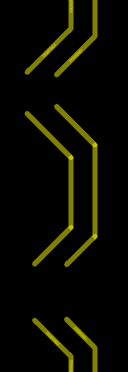

  • excellon1
    +1 excellon1 over 1 year ago in reply to masamasa
    Hi Masa,
    The Scalpel routine works like drawing a thick or thin line through the traces. Basically similar to a blade cutting something.
    If you run the command scalpel followed by a number, the number will be the width of the cut.
    For a 100 mil cut  try scalpel 100
    This will delete the trace segments by 100 mils wherever your cut line was placed. I don't know of any routine that works like drawing a polyagon.
    There is also another method that is faster for cutting clines, You could take your board into "Specctra" and use the cut and delete segment options to basically create any cut type you want really fast. In specctra you draw the first cut line then the next cut line which cuts the traces. You then delete the traces between the cuts.
    Best regards.
