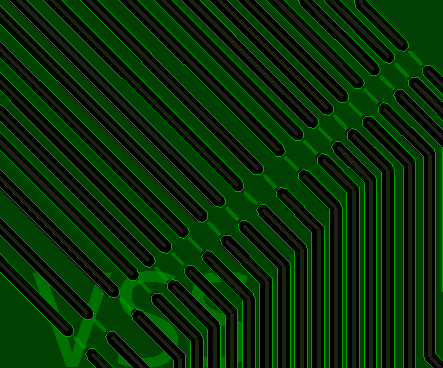

attached is an updated version of the 'scalpel' custom skill code with 2 changes:
Updated to correctly handle non-orthogonal/diagonal routing ( i.e. fiber-weave zig-zag routing )
Added 'undo' capability
https://community.cadence.com/cfs-file/__key/communityserver-discussions-components-files/28/scalpel.zip

    from the skill file...
    ; Description:
    ; Allows the user to draw a path through clines, and have a channel cut through them.
    ; Kinda like a scalpel, hence the name.
    ; Preparation:
    ; Position this file (scalpel.il) in the directory path where all other
    ; skill routines are located. In the allegro.ilinit file include the line
    ; load("scalpel.il")
    ; Usage:
    ; Type scalpel or scalpel n into the allegro command line, where 'n' is a number
    ; eg
    ; Command> scalpel
    ; or
    ; Command> scalpel 20
    ; where 'n' is the cutting width. The default width is 12mils or 0.3mm.
    ; When run, the user can left-click a path through clines, ending with either
    ; a double-click or right-button "Done". Right-button "Cancel" cancels the function
    ; with no cuts made at all.
    ; According to the user defined cut_width variable (below), or 'n' as an input,
    ; a path is cleared through any cline that is visible.

    Well crap, I had a typo in the original file I uploaded:
    D:\SPB_Data\>diff scalpel.il~ scalpel.il
    74c74
    < axlCmdRegister( "scapel" 'scalpel  ?cmdType "interactive" ?undo t)
    > axlCmdRegister( "scalpel" 'scalpel  ?cmdType "interactive" ?undo t)
    D:\SPB_Data\>
    Please use the corrected version below...
    https://community.cadence.com/cfs-file/__key/communityserver-discussions-components-files/28/5315.scalpel.zip
