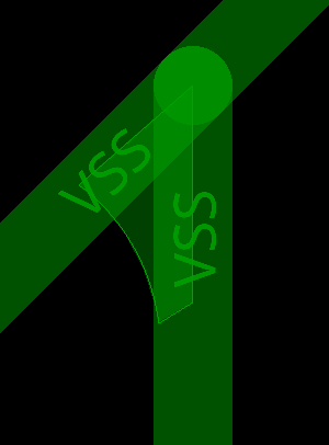

is there a way to detect a location with acute angle shapes?

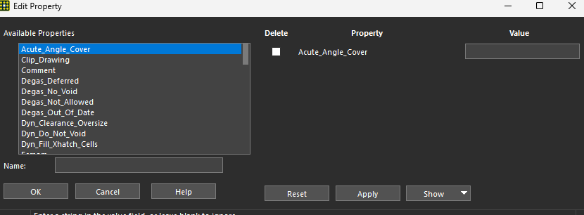

the edit property has a setting for the acute angle to avoid having acute angle.
but i would like to find the acute angle location on the deisgn that was made by our customer and has many acute angles.
regards
masa
  • steve
    steve over 1 year ago +2
    Yes, Setup - Contsraints - Modes - Design and then Acute angle Detection, set an angle andf type and enable the DRC to on.
  • masamasa
    masamasa over 1 year ago in reply to steve +1
    thank u for your response, steve. yes, it works for 90% of the cases. however, it does not work on the situation where a fillet creates an acute angle and a shape and a padstack intersect each…
  • DavidJHutchins
    DavidJHutchins over 1 year ago in reply to masamasa +1 verified
    I think I have some skill code that will detect the via to shape issue, let me know if you want to try it...
