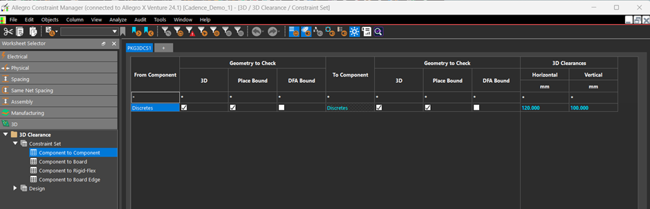

How do you specify 3D Constraints?
Once you have created your Cset in CM, click on Add Row in the Component-to-Component worksheet and you will be prompted with dialog box to specify the clearances.
Select the component or class and set the Horizontal and Vertical values.

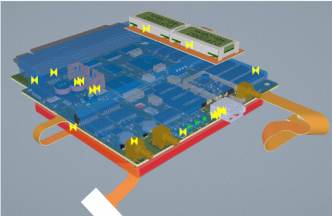

Once done, you can see the DRCs in layout as well as your 3DX Canvas.

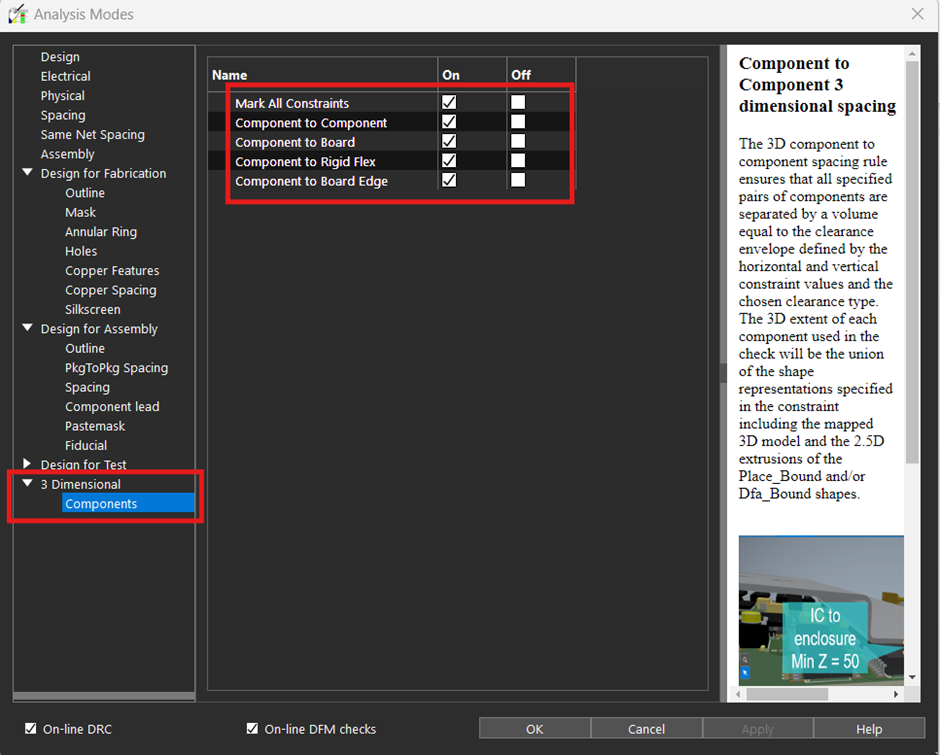

How to enable the settings?
To enable the settings, you have done for 3D DRC in Constraint Manager worksheet, make sure you enable them in Analysis Modes as well:
