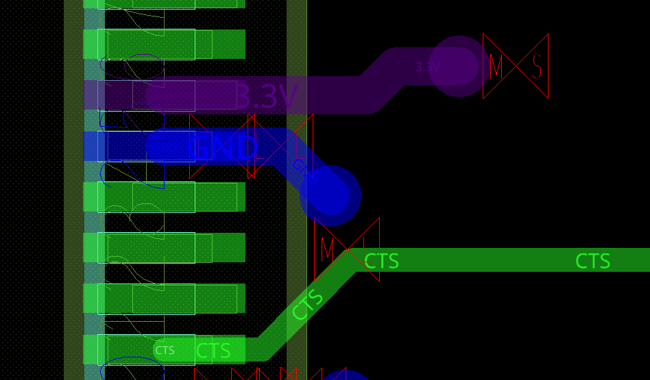

Hi there,
I am having troubling in DRC error in my design while practicing a very basic circuits in Allergo PCB designer.
I think I am missing some setting in solder mask to shape spacing.
Take a look
The purple one showing the solder to mask spacing problem and  green and blue one showing solder mask to PAD-Cline  spacing problem.
Help me to overcome these problem kindly.

    Have a look at Setup - Constraints - Modes or (Setup - Constraint Modes in OrCAD). Then Design - Soldermask and check the values you have set there for Soldermask rules. There may also be some set in Constraint Manager - Manufacturing - DFF - Mask but its likely based on the first ruleset.

    Thank you steve. Take a look what I want to do, at some point it works
