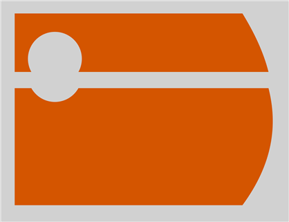

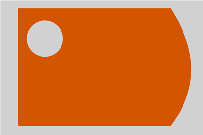

I need to create an SMD padstack that has an opening, like this:
When I draw this pad as a shape and try to save it, I get `ERROR(SPMHCS-3): Shape symbol cannot have a void in a shape.`. After a web search it seems to be a limitation of Cadence at the moment, so I tried doing two pads like this:
and then in my footprint incorporating the two pads and give them the same pad number. In this case, however, I get
WARNING(SPMHA1-301): Create symbol DRC errors exist.
Duplicate pin number 1.
WARNING(SPMHA1-298): Create symbol duplicate pin numbers.
ERROR(SPMHA1-291): Create symbol has been aborted.
What is the way to implement this?

    In such case, i will: - use a small round smd pad somwhere in copper area* - add a static shape on "ETCH/TOP" - add static shape on "PACKAGE GEOMTRY/SOLDERMASK"_TOP and "PACKAGE GEOMTRY/PASTEMASK_TOP…

    Hi bdc66a938f164d , An SMD pad with a hole is quite interesting! Could you help me understand the purpose or significance of having a hole or void in the pad? Given the current limitations, one workaround…

    Given the current limitations, one workaround I can think of is to manually create a void on the pad after importing the .dra into the board. It might sound like a bit of a hack, but it’s one possible way to achieve the requirement.
    That said, if I understand the intent behind the void better, I might be able to look out for any other workarounds.

    Thank you for your suggestion. I would prefer a solution that is defined in the footprint itself, because I have to instantiate a large number of these components.
    It is a type of coaxial connector that has the ground pad completely surrounding the inner pin. It can probably work similarly well if the ground pad is split in two halves with a gap in between, but the datasheet suggests to have a hole and I would prefer to do it that way.

    I think on this, one would need the exact datasheet, is it available ?. I took a look at that connector, The manufacturer does offer footprints for it but you have to contact them. That particular connector in the link needs a step drill to drill the board as the connector is basically press fitted into the board.
    On connectors that have a center pin either SMD or TH, You could treat the part as a one pin part only and draw the body as a shape around the pin. In the pcb editor you would assign a net to the shape - Gnd. Doing this would simplify part creation as from the perspective of the PCB Editor there is only one pin even though the body exists too as a shape.
