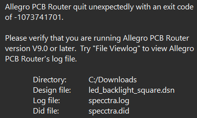

Hi, i get the following error when starting autorouter in allegro.
I tried a reinstallation - this does not give a solution. Further the specctra files are both created, but empty.
Same project works without any problems on another system. My HW is a HP omnibook with amd ryzen ai 9. The other Laptop is Intel I5.  May this be the problem?
Kind regards
Julian

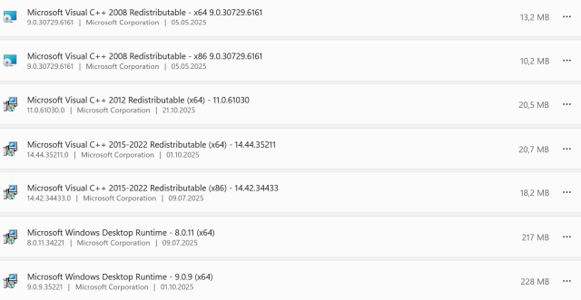

    FaPb over 1 year ago +3 suggested
    I got this reply from support: Starting from version 22.10 ISR09 , the Cadence SPB installer no longer includes the "Microsoft Visual C++ 2012 Redistributable Package (x86)" that are required for the…

    It is installed only for current user, running Windows 11 on both machines. Starting specctra vom /bin/ gives error 0xc000007b.
    With Process Monitor i found, that obviously MFC110u.dll is missing. This seems to be included in visual studio 2012 redist. Also installing this is not changing this error.

    I guess the installation process is not the right. I will try a new, for all users and have a try again. License works. Allegro PCB Router does somehow not exist..
