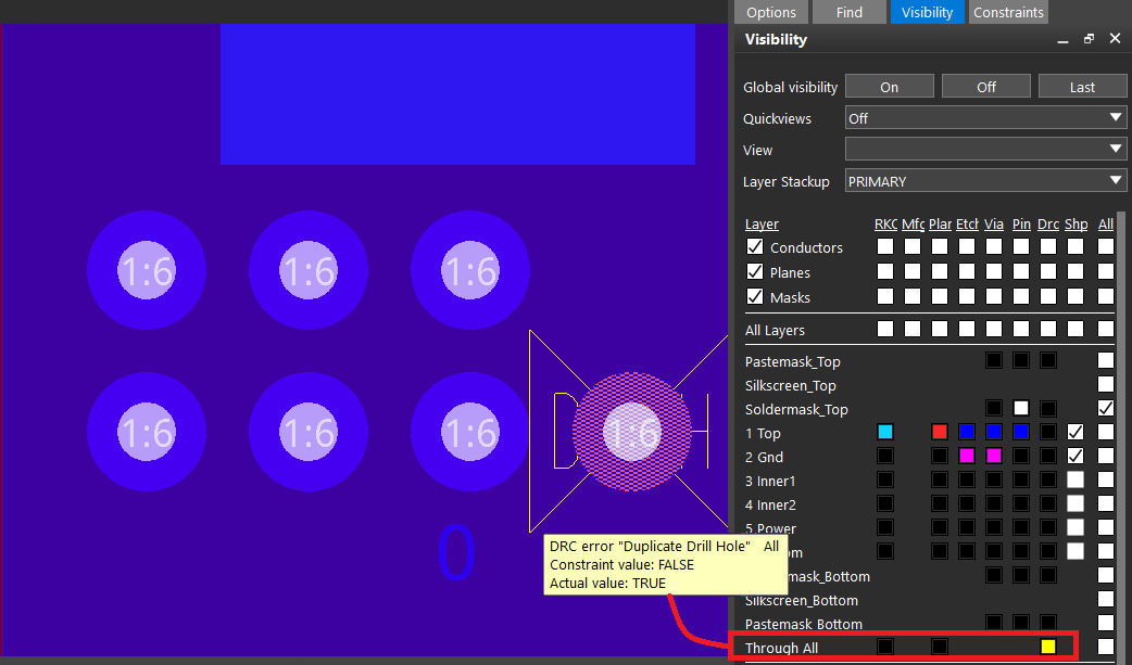

I have an RF design and I am using the "Place/Via Array" tool. In some parts it is doing this:
When I click on "DRC/Update" it does not even mark them as an issue. I have these settings:
When I run the `dbdoctor` command, nothing happens. I guess because it is not even considering this as a DRC.
How can I remove the overlapping vias or at least show a DRC where they occur?

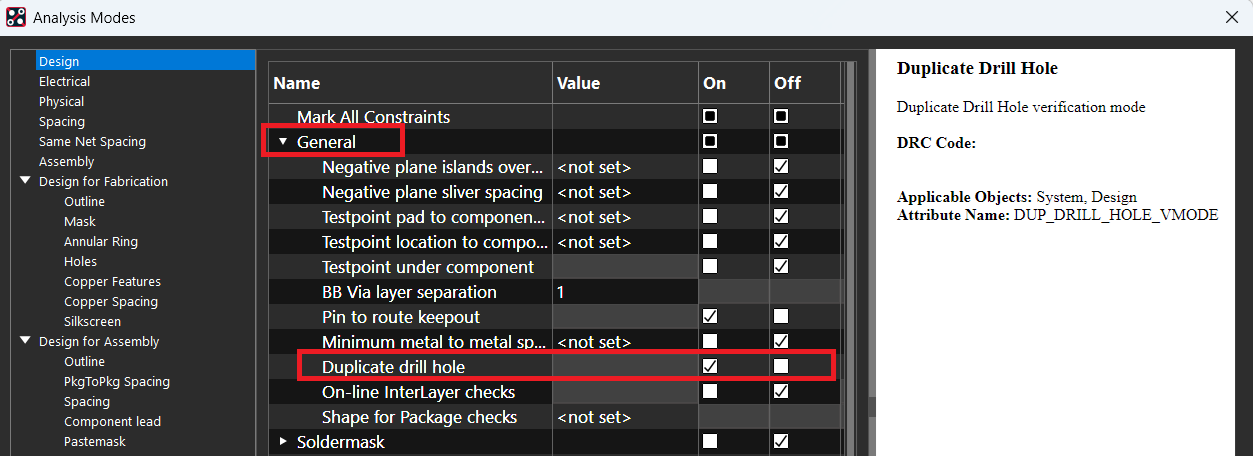

  • John T
    +1 John T 11 months ago in reply to Robert Finley
    Hello all, it looks like you could do with a check for such mistakes... never fear, I got you covered!
    So there is a check for duplicate overlapping vias in the form of duplicate drill hole checks.
    I just retested this here to be sure.
    Please open the Analysis Modes form and in General checks you find it as shown below;
    On a demo design I snapped two through-hole gnd vias in an overlap scenario shown below.
    Please note you will make the DRC flag visible using the "through" drc category.
    Hope this helps!
