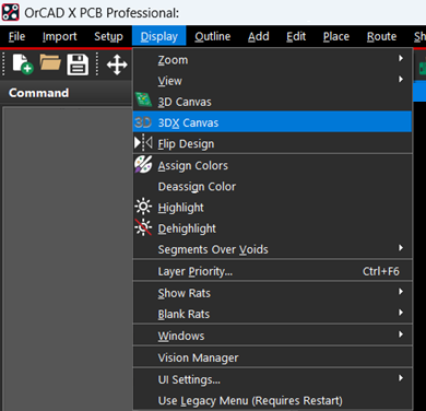

I'm using OrCAD X PCB  Designer on 25.1 with the path S010 and the 3D icon (Not the 3D Canva icon) is missing, I have check all the icon in the menu but i still don't have the 3D icon.

    If you go to this menu, do you have the option to start 3DX Canvas?
  • QI202602231047
    0 QI202602231047 8 months ago in reply to JuanCR
    This problem is only when I'm editing a .dra
    But when i'm editing a .brd I got it.

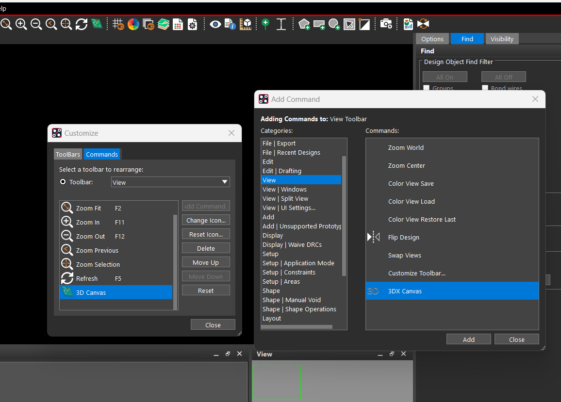

  • JuanCR
    0 JuanCR 8 months ago in reply to QI202602231047
    Go to View > Customize Toolbar and navigate to this screen:
    So, it's the Commands Tab, then choose the toolbar "View". You should see that the last command is "3D Canvas" (missing 3DX canvas). Click on "Add command" button. Then, in the pop up window, choose "View" and find the "3DX Canvas" command.
    I'm not sure why you don't have this command visible but the only thing I can think of is that it was deleted by mistake. Let me know if you have any issues following my steps.

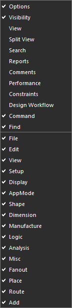

  • QI202602231047
    Sorry for my late replay,
    I have to install the 16.6 version for project and after that I Don't have the 3Dx On the .Brd to.
    I have install the last Hotfix SPB25.10.020 and it does Nothing.
    There is a screenshot of my command toolbar customisation :
    I can't see the 3Dx Icon on the list.
    I can't insert the image so there is a link to see it : https://ibb.co/9MNbnMD
  • QI202602231047
    0 QI202602231047 7 months ago in reply to QI202602231047
    Ok I have seen that you can type '3DX' on the command bar and it should open the 3DX menu but when I dot that it does nothing.
