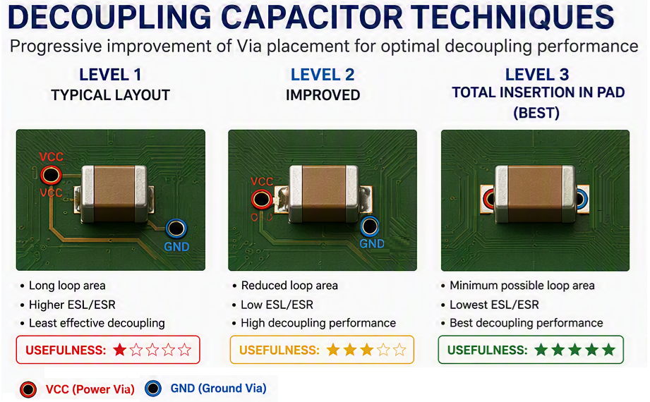

We see many designs every day but most do not follow the performance recommendations when it comes to power and ground via placement for decoupling capacitors.
Why ?
What is preventing you from pushing your designs to perform at their electrical best:
1. Is it costs?
2. Is it due to manufacturing or fabrication?
3. Is it speed for design completion or DRC management?
The highest level recommendation is to place grounding and power vias inside the capacitor pads
Let’s share some industry experience if anyone has overcome these hurdles or have suggestions or reasons for the approach.
Appreciating any thoughts or comments below.

    We don't use via-in-pad. We produce 1M+ units a year. Expense and manufacturing issues outweigh benefit for us. We typically use #2 with vias tied to planes, and wide traces. We use a lot of 0201…

    Hi John,
    Good topic. The caps look too big for the pads :), probably just to illustrate I'm sure. So Level 3 works very well, I have used this fairly regularly as I do RF based layouts into the GHz. Typically for a 62 mil board a hole size of 12 to 20 mils works fine in this regard, never seen any wicking thus far. On small land patterns such as  say 0201's the hole size should be smaller as one would expect. I am unsure if most designers use this method, If not it could well be just an exposure type of thing to this method.
    Even if you don't decide to use level 3, L1, L2 should be avoided. The trace coming off the pin is too narrow. On a physical board these type of traces will add a few nano henry's of inductance. A better approach is to route off the pin with a trace width that is the same or bigger than then pin. so as to minimize the actual inductance.
    On critical gnd nets if one routes off the pin, it is common practice to seed two via's or more to ground if they will fit. Basic idea is minimize path length & inductance.
    Best Regards.
  • John T
    John T 3 months ago in reply to excellon1
    Absolutely, excellon1. Great to read your insights and interesting applications. Yes big vias shown to help the illustrate the point. About the level 2 image, before I posted I thought about adding double vias here but just let it run. Good spot. I think the trace and pad teardrop/tapering functions in the PCB Editor could be useful here too for SI reasons although they were invented for fabrication reasons. What do you think?
    So is there anyone seeing any issues with 3mil (0.3mm) vias or higher when doing Level 3??
    The soldermask need not be fully open btw, or perhaps others have some tricks up their sleeves worth sharing. I wonder if we should add vias directly in the dra file in the library just to ensure double-via presence. 0201s indeed becomes challenging with which via hole-size we can use...
    We use a lot of 0201 decoupling caps.

    Hi Avant, yes this rings a bell with me too having previously designed for high volume production also.
    Does anyone ever pre-plan placement to account for smd side1 versus smd side2 assembly? One neat trick we came up with was placing vias in pad for components placed on the smd 2 side. Side 1 being already pasted and soldered; any paste that might come through due to the side 2 soldering will then not cause any interference with production of the opposite side, such as no stencil lifting.
    Would be interested to hear any other thoughts or tricks!

    I should have clarified - Our designs are usually single-sided with only optional memory and related components on the back side.
    Decoupling caps for the top side components are on the top side. Placement is not ideal.
    Interesting idea about vias on smd 2 side.
