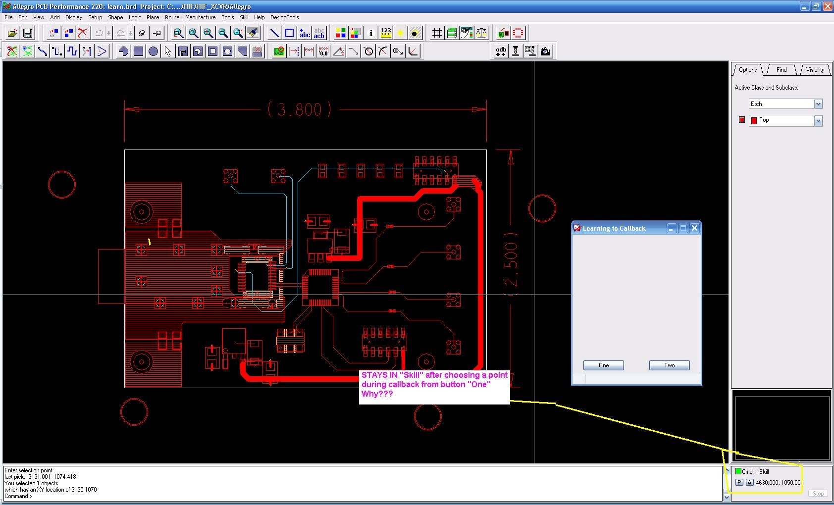

Hi All,
First skill program...and it almost works.
Initiallly I wrote inline code that did not use a form but prompted the user to enter a point.  It worked, I did a calculation and the code exited cleanly.
Then I added a form (with buttons) but had a dummy callback and again forced the code to run once inline and it worked.
Now I have added a button callback which is working except for the fact that when the code is done executing the status light in the bottom right corner is green but says "Skill" whereas inline it would be "Idle" as expected.
By elimination I can get clean operation (but useless) by eliminating my call to axlSingleSelectPoint.  The code goes merrily on its way and alerts me that I failed to select a valid object and waits for a new button press.  All the while after each button press the indicator goes back to "Idle".
As soon as I re-enable the selectPoint call that piece of code grabs a point, determines what to do and executes with good results but the status is "Skill" at the end of the code execution.  It works repeatably for each button press.
So...what is it about axlSingleSelectPoint that might be causing a callback to hang?
Thanks,
Bill

    This is a trimmed down version but it demonstrates the problem I am having.  Button TWO goes back to idle.  Button ONE stays in "skill"
    (Note: for some reason Cadence doesn't accept .form files!!!  Hello Cadence?
    Change the button_form.txt to button.form for it to work)

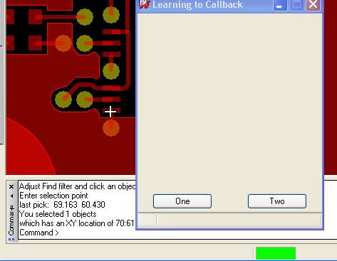

    Hi Bill, That's not a bad first effort. I loaded your code and it works fine for me in 16.01. Are you running the latest Hotfix? Cheers, Dave

    Yes, and I see the 'Skill' status displayed in 15.5.1 and 16.0.1 w/Hfix. On multiple machines as well. Can you double-check button one for me? Thx!
    Originally posted in cdnusers.org by redwire

    Hi Bill, See attached screen capture image. Button one works as I would expect. If you have the Skill panel open, the messages will appear there. Cheers, Dave

    Hi Dave,
    Yes, that part of the screen (CIW) matches but take at my attachment.  Are you in "Skill" or "Idle"?
    Thanks,
    Bill
