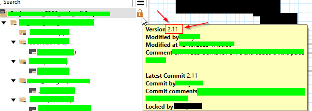

I am using Allegro X 24.1; System Capture, PCB Editor and are saving both schematic project and layout in Pulse.
I want to display which pulse commit I am looking at on my schematic title block - I have been doing this in other software that has revision handling and it is very practical both during actual design work and when sharing and discussing projects to know which version are currently shown.
It seems like it should be a simple enough variable to fetch from the system with something like $PulseVersion or similar.
I have done my own workaround by creating my own custom variable called PulseVersion and then run this TCL "script":
modifyCustomVar -name "PULSEVERSION" -type "Project Defined" -value "[dict get [dict get [pulse::getVersionDetails] Attributes] displayRevision]"
It will return current pulse version like "1.0" or "4.2" or "1.33.7" depending on your current commit version.
But its a manual step that in my opinion should be automatically updated when commiting. Has anyone found a better way?
I would love to have a similar solution in pcb editor also, but have not even managed to do a manual workaround in there yet :/

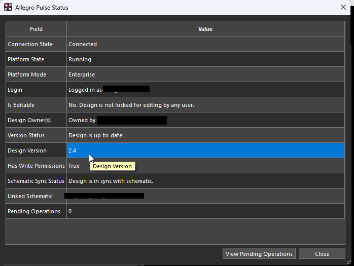

    CadAP 10 months ago in reply to RJ202412171240 +1 suggested
    RJ202412171240 Please command axlPulseGetDesignStatus to get the design version status.

  • RJ202412171240
    0 RJ202412171240 10 months ago
    In the best of worlds, I shouldn't have to generate a variable by myself.
    What I really want, is an easy way to fetch and display a variable that already are in the system.
    When I hoover over the project, I can see the pulse version like in the attached image.
    Best would be if I could just fetch that variable somehow and add it to the schematic page.
    Is this such a unusual thing to require from a built in version control system? To me it seems like a very basic function and also a core necessity for the usability of a revisioning system.
    Are any other using cadence pulse, and if so, how are you using version control?
    Edit:
    In PCB editor this numbers can be found when clicking the pulse icon, entering "Allegro pulse status". Like the image below. This show that also this system have the variable somewhere and should therefor be readable somehow, right?
  • CadAP
    0 CadAP 10 months ago in reply to RJ202412171240
    RJ202412171240
