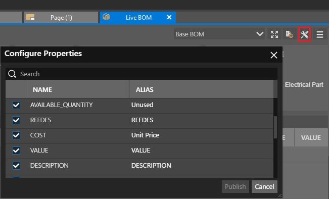

    How can I add injected properties in Live BOM in System capture standalone?

  • Akshay khosla
    0 Akshay khosla 3 months ago in reply to Electro Node
    Hi
    Thanks for your active participation in the Live session.
    By default, injected properties are not annotated to the schematic and therefore, they are not available in the list of properties in Live BOM > Configure Properties.
    To include injected properties in Live BOM, they must be annotated/transferred to the design.
    Depending on whether you are using System Capture in standalone mode or in Pulse Environment, injected properties can be annotated on the schematic.
    Standalone System Capture
    Like DE-HDL, if you are using System Capture in standalone mode, the annotation of injected properties and their visibility on the schematic canvas is controlled through the pptoptionset.dat file. The path to the pptoptionset.dat file is defined in the CONCEPTHDL section of the site.cpm file.
    START_CONCEPTHDL
    PPT_OPTIONSET_PATH '$CDS_SITE/<path_to_ppt_optionset>/ppt_optionset.dat'
    END_CONCEPTHDL
