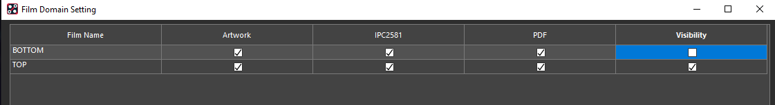

I have a skill routine that I'd like to loop through the film files listed in Allegro's visibility panel view drop down list.
Currently to get the list of film files I'm using axlGetParam("artwork")->groupMembers
The issue is that the film file list also includes those that are toggled off for visibility in Film Domain Settings(see image below)
In an attempt to find artwork visibility value, I used axlPrintDbid which has visibility under Domains but it seems to be dead end (see below)
Any help is much appreciated
Thanks,
David Nguyen

    Use: p = axlGetParam("artwork:SOLDERMASK_BOTTOM") p ->domains will return what is enabled. i.e. ("ipc2581" "pdf" "artwork" "visibility")

    Use:
  • Dave413
    0 Dave413 over 1 year ago in reply to DE202408202727
    so that was what I was missing, thanks fellow Dave!
