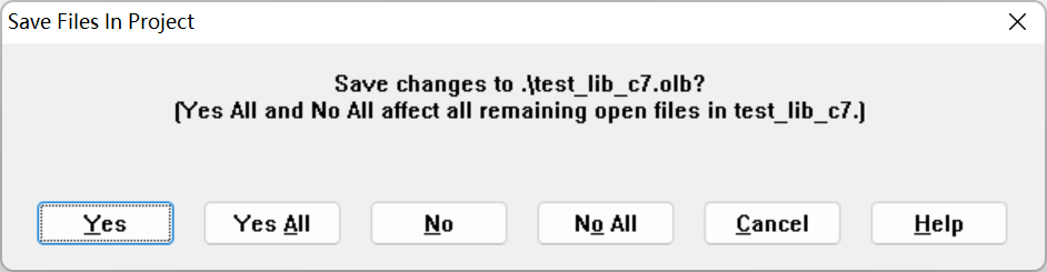

3.When I save the project or library after modify with the code blow, It will pop up a window that needs to be confirmed, but I don't need the step, I want just save it directly.
# the code use this:
DboSession_MarkAllLibForSave $lLibSession $lDboLibrary
DboSession_SaveLib $lLibSession $lDboLibrary
# the confirm window like this:
