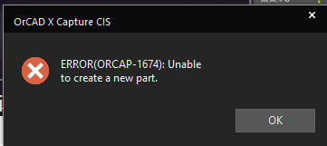

I am trying to clean up some old libraries i.e. move unused parts from active.olb to unused.olb. The code is presented below. Everything works pretty well except that there is something hanging inside active.olb that prevents creating a part that was there before. E.g. if PART_123 was moved from active olb to unused.olb, I can not create PART_123 again. If I look inside active.olb file, PART_123 is still mentioned, despite not being shown in the lib tree structure. I guess I am missing some cleanup in my code, but I can't figure what exactly, so I am asking for your help.

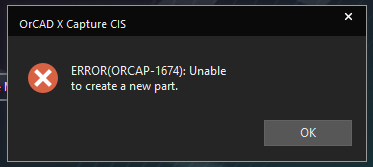

    This is no different than my code, except your code operates on a loaded olb. Both scripts delete the package indeed, but when I try to recreate one of the packages that was deleted, Capture throws an error.
    This was exactly the problem I was trying to solve since the begining.

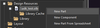

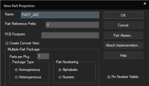

    7. Save OLB and then Right click the libary to create again PART_ABC (see image below)
    8. I get the error as shown
    Step 4:
    Step 5, before running script:
    result after step 6:
    step 7:
    Step 8:

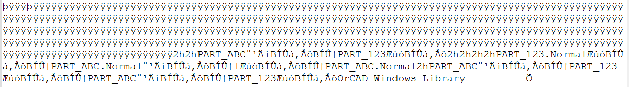

    After step 6, if you open the OLB with a text editor, you can still see PART_ABC and PART_123 mentioned in the file, despite them being deleted, and I think this is what causes the error.
