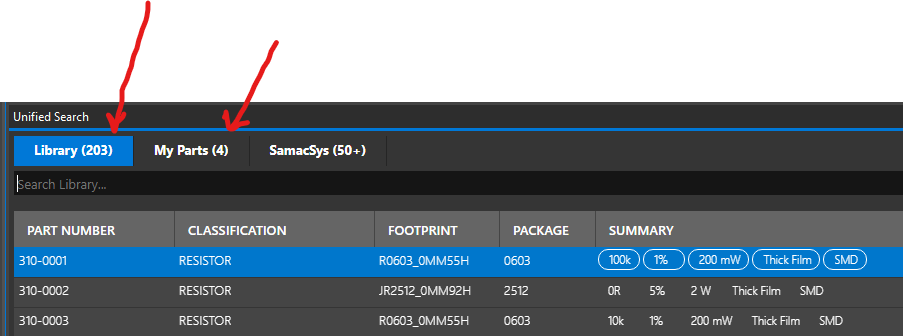

I've been creating new symbols using Part Developer in a dev library. Once I'm happy with the symbol I copy the part folder (which contains other folders i.e. chips, entity, metadata, part_table and sym_1...) into my main corporate library.
Most of the time this goes great. I open the system capture tool and the unified search and I can find my parts under 'Library' However sometimes the new symbols only show up under the 'my parts' library tab.
1) What causes a symbol to show up under 'Library' vs 'My Library' tab in the unified search window?
2) How can I change where a symbol shows up?
I have >200 created symbols in the 'Library' tab, but the latest four symbols I've created are under 'My Parts'

    Under 'Library' - Corporate/referenced libraries or libraries from site appear under this head. 'My Parts' - Libraries which are local to project fall under this head. For more information. please…

    How do you have your library paths configured with a project where you see this and with a project where you don't?
  • RS20250716671
    0 RS20250716671 10 months ago in reply to Elecguy
    I have a SITE setup for libraries, so it's the same for both.
    However, I think that I have discovered the reason. It looks like the pulse server (that runs when you launch the System Capture tool) needs to rescan the directories after I add new symbol folders. If I shutdown the tool, wait, then shutdown pulse server, wait, then finally re-launch System Capture the new symbols will show up in 'Library'
