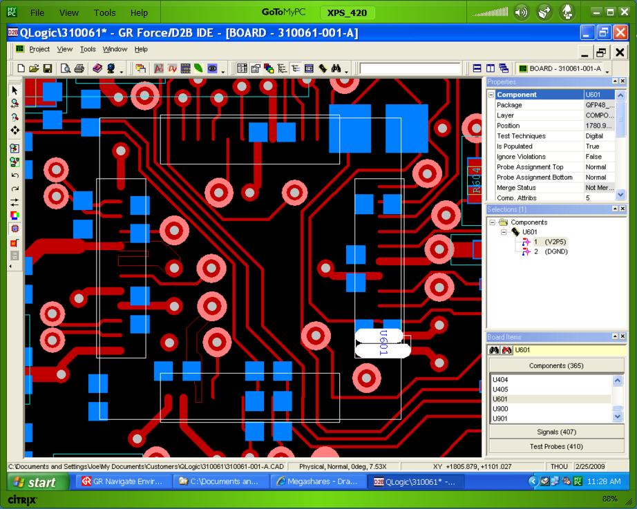

    Mike.
    This extract file is doing the same thing mine was I get only one or 2 pins on a part the symbol file is not outputting the all of symbol info even though it is there.
    I attached a file that shows how it read in
    Carl

    mcatramb91 over 16 years ago
    Carl,
    Sorry for the delay in my response, I was traveling and away from my email.
    It may be that "extract" is crashing before it completes, for some reason, so you are getting a partial file.  I would suggest breaking up the extract view file "valext.txt" into 5 separate extract files, run separate extracts then review the extract.log file for any errors or abnormal exits.  You can try the SKILL version that Dave suggested but it will probably give you the same results.
    Another suggestion is to open up the route file "rte.txt" to see if you see more than pins 1 and 2 for U601.  If you do see more than Pins 1 and 2 than compare the other Pin lines to see if something jumps out or looks to be out of place.  I can take a quick look at the file and maybe I could figure something out. I will only need a partial file for review but it will need to be attached to the post and not in the body.  It could be a component related issue or a net related issue but I would need to look at the file to figure it out.
    One final question:  Does this problem exist on only U601 or is there other components that exhibit the same problem?
