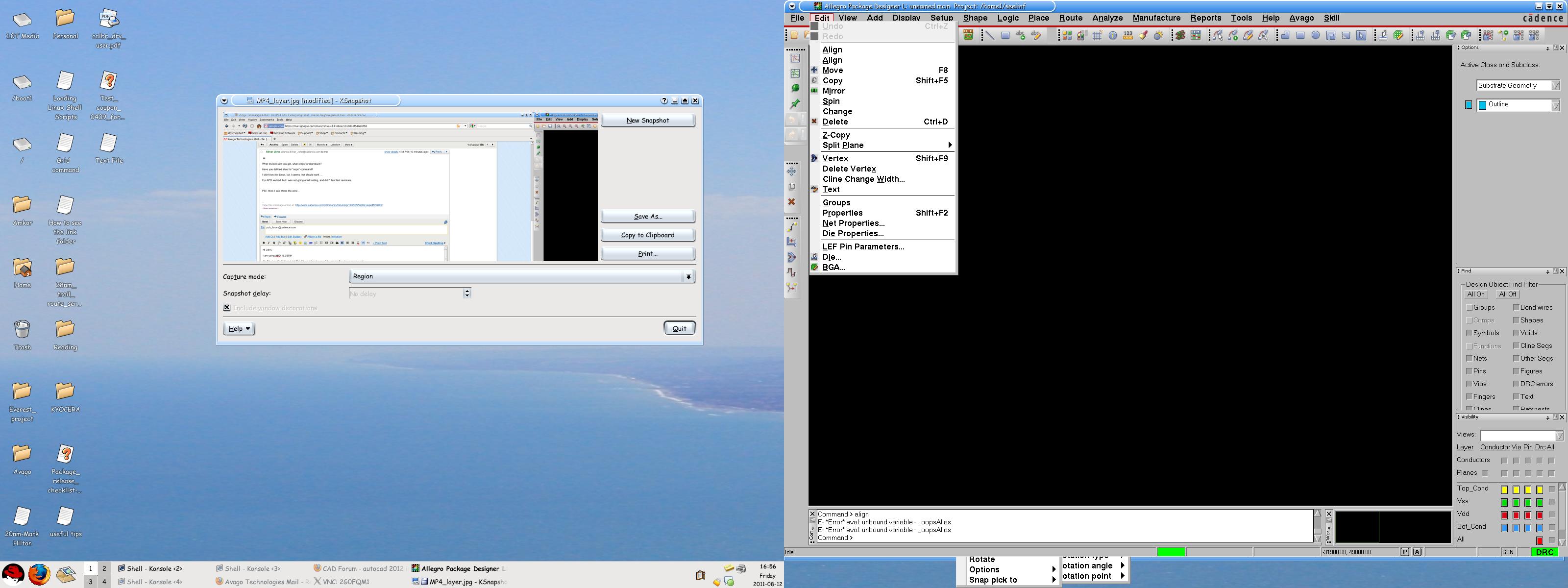

    I am download the Kapustin-align-tip.tar.gz and is not working for me the error as below:
    E- *Error* eval: unbound variable - _oopsAlias
    Can the skill code use for APD?I am running it on Linux.
    Pls help.
    Regards
    Elaine

  • Welcome04
    Welcome04 over 14 years ago
    Hi John,
    I am using APD 16.3S034
    I did not defined alias for "oops"command.
    1.The command prompt also appear like this after finishing launching the APD.
    0 ==== ("move" nil (("&Align" "align")))
    2.The pull down menu have 2 edit, see attached.
    3.Skill > load("align_do.il")
    function onTop redefined
    function doTop redefined
    function doMoveTop redefined
    function onBottom redefined
    function doBottom redefined
    function doMoveBottom redefined
    function onLeft redefined
    function doLeft redefined
    function doMoveLeft redefined
    function onRight redefined
    function doRight redefined
    function doMoveRight redefined
    function onCenterH redefined
    function doCenterH redefined
    function moveToHorizontal redefined
    function onCenterV redefined
    function doCenterV redefined
    function moveToVertical redefined
    function onDistributeH redefined
    function doCalcStepH redefined
    function doDistributeH redefined
    function doCalcStepBetweenBoundaryH redefined
    function doDistributeGapBetweenBoundaryH redefined
    function onDistributeV redefined
    function doCalcStepV redefined
    function doDistributeV redefined
    function doCalcStepBetweenBoundaryV redefined
    function doDistributeGapBetweenBoundaryV redefined
    function onPickH redefined
    function doPickH redefined
    function onPickV redefined
    function doPickV redefined
    t
    4.Skill > load("align.il")
    E- *Error* setq/set: Variable is protected and cannot be assigned to - STORE_PLACE
    E- *Error* load: error while loading file - "align.il"
    ERROR
    5.Skill > load("align_utils.il")
    function griddedPoint redefined
    function getCurrentGrid redefined
    function maxX redefined
    function minX redefined
    function maxY redefined
    function minY redefined
    function orderByX redefined
    function comparePositionX redefined
    function orderByY redefined
    function comparePositionY redefined
    function getObjectLocation redefined
    function getPinLocation redefined
    function getObjectBBox redefined
    function getBBoxes redefined
    function getMinBBoxX redefined
    function getMaxBBoxX redefined
    function getMinBBoxY redefined
    function getMaxBBoxY redefined
    function refreshIDs redefined
    function checkForFixedObjects redefined
    function moveObject redefined
    t
    Regards
    Elaine
