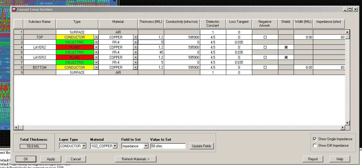

I ran into something the other day and have been working with tech support on, but thought I might get some answers here.
Four layer board, two inner layers set to planes (and shield) FR4 material.
In the Setup - cross section tool, when I try to calculate the trace width based on a given impedance and stack up, the impedance is always 60 ohms. For example, I open the cross section tool and select Show Single Impedance.  The default impedance shows as 60 ohms. If I try to change it to 50 ohms by manually editing the cell, it resets to 60 as soon as I click out of the cell.
If I try to change it by using the drop down boxes at the bottom of the window; Layer Type - Conductor; Material 1oz cu; Field set to - Impedance; Value Set to - 50; then select "Update Fields", nothing happens.
We tried multiple things yesterday. I even sent the board file to tech support and it works just fine for them (figures.....)
I tried it on a different computer at my home office and the impedance is displayed in exponential format, not in ohms.
A couple of screen shots:

     This bug has been around a while.  I filed it back when 16.2 came out.  Cadence swore it was me and not them. It was Cadence.
    I had even been part of the BETA test team for 16.2 and it failed but my failures were discarded since the other BETA testers did not see it.  What was the issue?  Everyone at Cadence is running a higher license level and the solver just quits quietly for those of us with Performance licenses only.  They have to test at the lower license levels to see the problem but it has to be a machine that has never had or can not have access to a higher license.  Finally a hotfix came out for 16.2 and now I see it's back...sigh...
