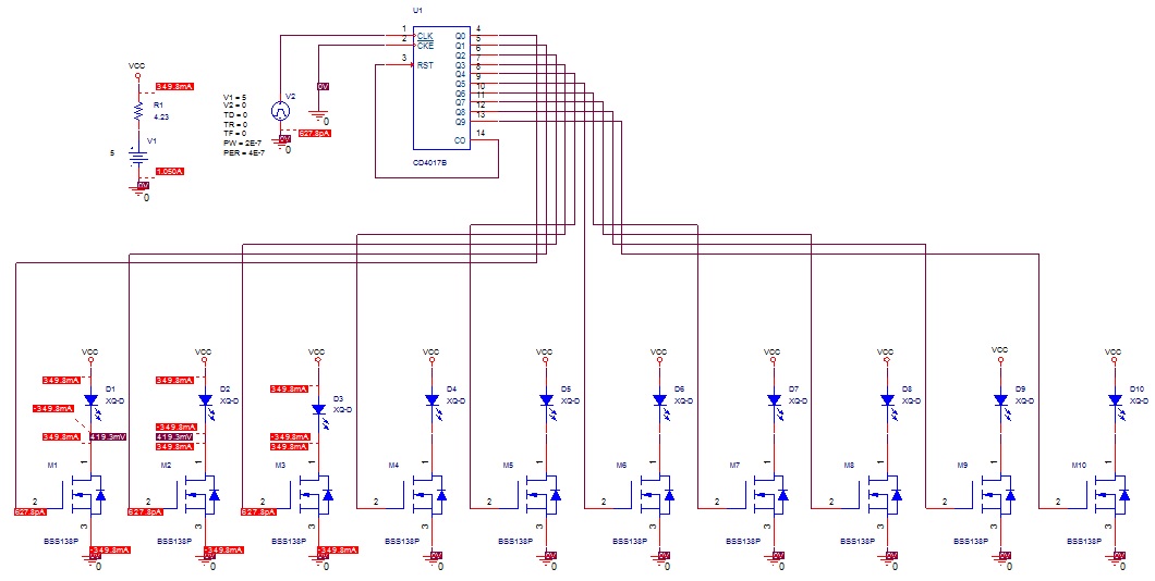

I think it's missing some lines. Shouldn't there be a line starting with ".model"?

    As "alokt" posted, you don't have all the libraries because you are running the evaluation version, also from the last message in the screenshot, even if you did have all the libraries correctly configured, your circuit has more than the 75 circuit node limit, so it will not simulate without a licensed installation.

     Yes I know there is a limit with the free version of the software. What is a "node"? I've attached the circuit I'm trying to simulate.

    Any Voltage node is a node, also be aware that nodes may exist internally to the models and may be added depending upon the simulation requirements. In your case, the counter has internal nodes and nodes are added to convert from the "state" of the digital simulation to the "voltage" of the analog components, mosfets in this case, also the mosfets have internal nodes. From a circuit that I drew from the picture of your circuit, I got a node count of 159, over double the evaluation simulation limit.
