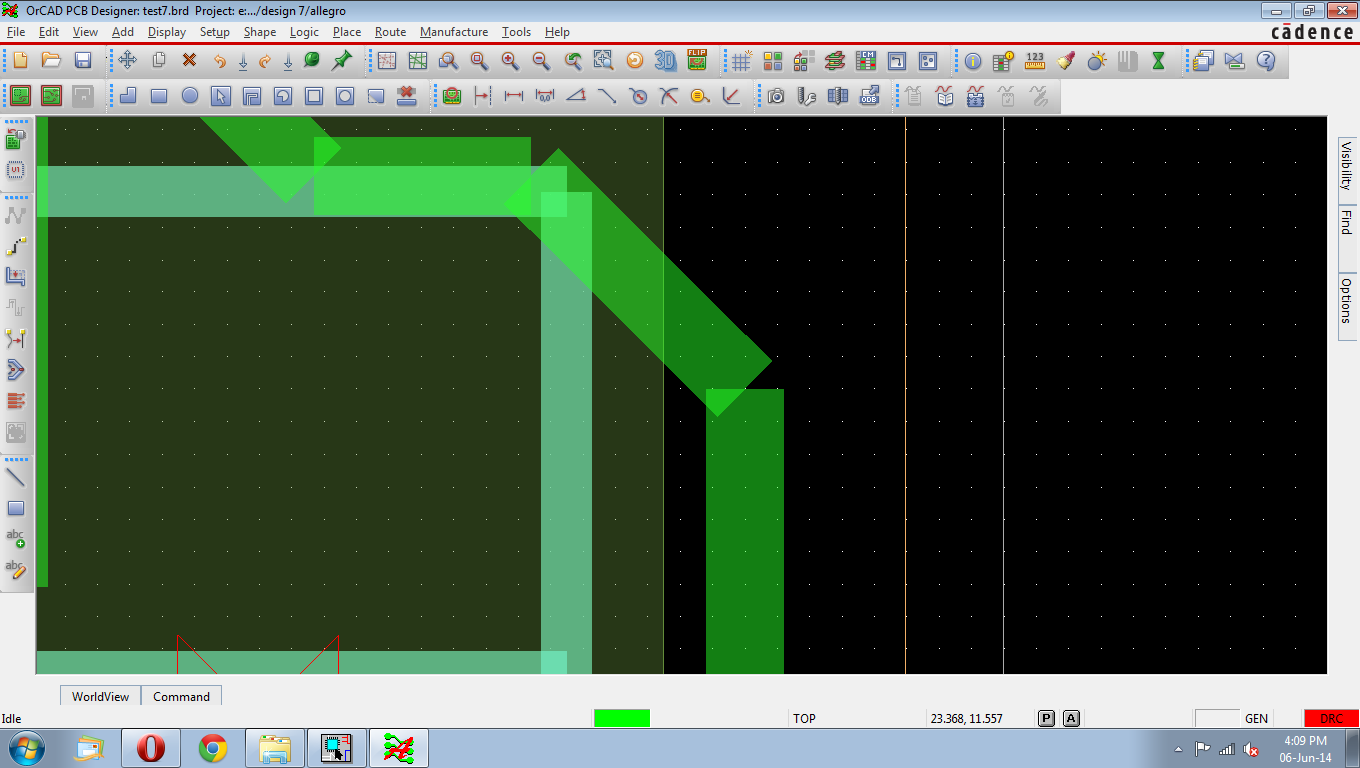

Hi..
I had routed the sample board and then when i am trying to slide the track means that time the corner of the tracks is been cutout. i don't what is the problem for that?
I had attached the png image with this post. tell the possible solution to avoid this problem.

     Look at Setup - Design Parameters, display tab and turn on Connect Line endcaps.
