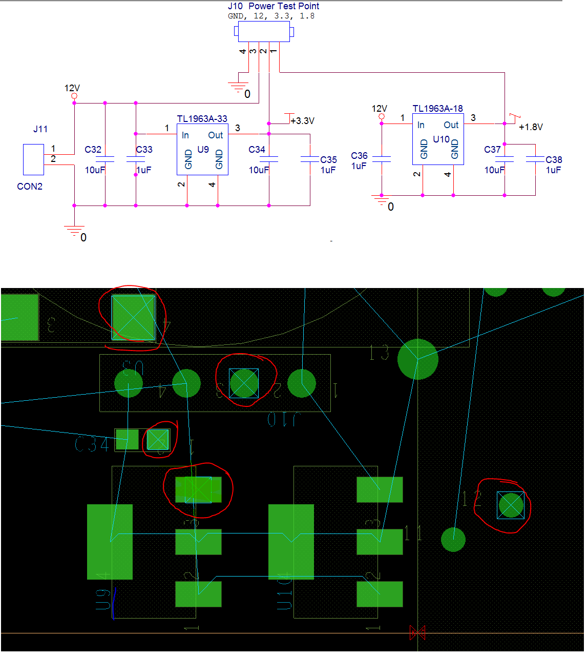

 Hi Guys,
I've only been using ORCAD for about 2 months now, so I'm sure this is a silly problem. I seem to have an issue with one of my nets - I am getting an "x" over all of the pads in the net and not a single component appears to get associate with that net. I have attached a screenshot of a portion of my schematic and layout, and can attach more/provide more information if needed.
Thanks,

    chads108 over 11 years ago
    That net, or nets, are associated with a power or ground net.  The system uses some key words and automatically assigns them that way, assuming that you will be connecting them to a plane.

    zquinn3 over 11 years ago
     Ah, you're onto something there! Yes, this used to be a 4 layer PCB with a plane for that net. But now I have deleted that plane. Any idea how to get the software to recognize that plane is gone and the net must now land on the top/bottom layer?

    redwire over 11 years ago
    You either have a voltage property on the net or as chads says it has power property on it. Use constraint manager or edit-> property to examine. If it is coming in from orcad it will keep coming in until you change it.
     Thanks guys. Constraint manager actually wasn't showing that net, so I went into Orcad and removed everything associated with that net. Then reassigned everything. Once in Allegro it worked as expected. Thanks for the tips guys!
