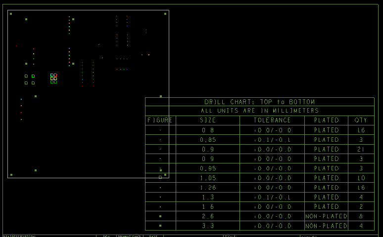

I have designed a relatively large PCB using a predefined page, when I go to create the NC drill table it is to large to fit in the page outline next to my Layout (shown below)
Is there a way to shrink the Drill table as I would prefer not to modify the Page outline
I am running 16.6 with the latest patch
Thanks for any help in advance
  • steve
    steve over 10 years ago
    Locate the default-mm.dlt file (normally C:\Cadence\SPB_16.6\share\pcb\text\nclegend and open with a text editor. You can change text block size etc. Read the file carefully and adjust to suit. Save this as a different name and then browse for this new template from Manufacture - NC - Drill Legend.
