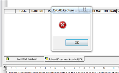

After setting a local database, I would like to be able to add component from the Internet Component Database (ICA).
First issue, when I click the ICA tab, an empry pop-up opens, there is no error code or message, just the following pop-up:
After clicking OK and the Go/ICA Home Page, I'm able to search for a part as expected until I chose one:
I can't see any Schematic Image  and I get a WARNING(ORCIS-6085) when trying to place the part:
Can anyone explain me how to solve those issues ?
Thanks in advance,
  • oldmouldy
    oldmouldy over 9 years ago
    If you are still running 16.5, that is no longer a supported version.
    The ICA capability is at end of life, so access to it may be variable.
    You don't have a library named discrete configured through Place>Part, Add Library or [Part Library Directories] section in the Capture.ini file, that contains a graphical symbol named R.
