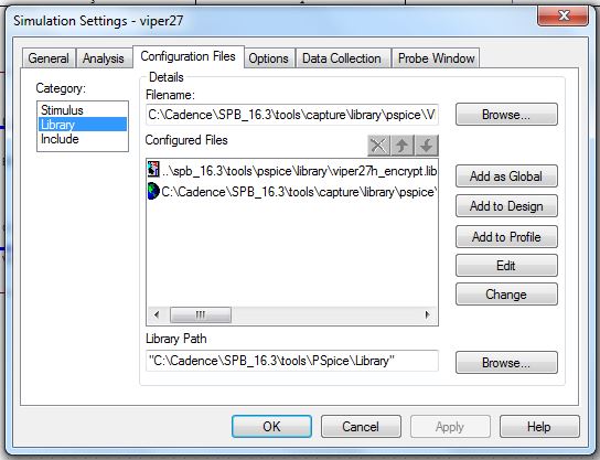

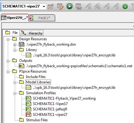

I am trying to import the following model into PSPICE but I am getting an error.
www2.st.com/.../viper27.html
I copy the 2 (.olb and .lib) files to c:/cadence/spb/tools/pspice/library
Inside orcad capture, I import the .olb file into place part.
next I add file (.lib file) into library under Design resources
I copy this same file into Model libraries under Pspice Resources
I have connected all the pins to ground.
Inside configuration fieles
But I get the following error.
How do I make it work? I have followed this On Semi guide to importing external vendor models.
www.onsemi.com/.../TND6045-D.PDF

    Provide the full library paths, the screenshots have truncated the paths. You are almost certainly missing the nom.lib library reference AND there are no simulation libraries in the tools\capture\library directories, they will be schematic libraries.

    Hi OLDMOULDY, How to add nom.lib? When I try to add nom.lib I get the following error
    ERROR [CAP0032] File 'C:\Cadence\SPB_16.3\tools\pspice\library\nom.lib' is not a valid library file.
    The library paths are as follows.
    Design Resources:
    C:\CADENCE\PROJECTS\viper27h_flyback_working.dsn
    C:\CADENCE\spb_16.3\tools\pspice\library\viper27h_encrypt.lib
    Outputs.:
    C:\CADENCE\PROJECTS\viper27h_flyback_working-pspicefiles\schematic1\schematic1.net
    Pspice Resources:
    Simulation Profiles:
    C:\CADENCE\Projects\Viper27H_flyback_working-PSpiceFiles\SCHEMATIC1
    Please help me organize and run this simulations I have add many more components. Thanks.

    Can you please check if you have - 'C:\Cadence\SPB_16.3\tools\pspice\library\nom.lib file present in you installation?
    Also confirm if you are running licensed version or Lite version.
    Having complete error message or .out file would help identify possible root cause of error message.

  • oldmouldy
    oldmouldy over 10 years ago
    Now the issue is with D1 in your design, it looks like you have used a diode from the "PCB" library rather than one from the PSpice libraries that would have the necessary simulation properties set.
