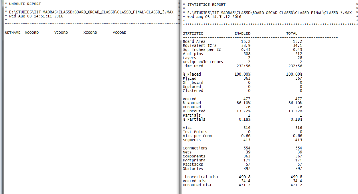

I am using orcad layout. To check the unrouted nets, if i use Auto-> create reports and select 'Conn unrouted', it shows no unconnected nets. However, if i check the 'statistics'  spreadsheet, under routing statistics, it shows 86% routed.
I am not sure which one to believe. I don't see any ratsnest when all the nets are enabled for routing. Also, the statistics spreadsheet doesn't show which nets are unrouted.
Please help me out.

    Can you attach a screen shot of Statistics? The design may be broken but, since March 2009 marked the end of OrCAD Layout, there might not be a lot that you can do from here.

    Please find attached a screenshot of the statistics.

    You have some elements that are not enabled, differences between the "stats" for Enabled and Total. In any case "stats" are to be believed, try a backspace followed by 0 to display the global layer and then you should be able to see the unrouted connections.

    Thanks for your reply.
    I have tried that. However, I can't see any ratsnest displayed. And in the nets spreadsheet, all the nets are enabled for routing.
