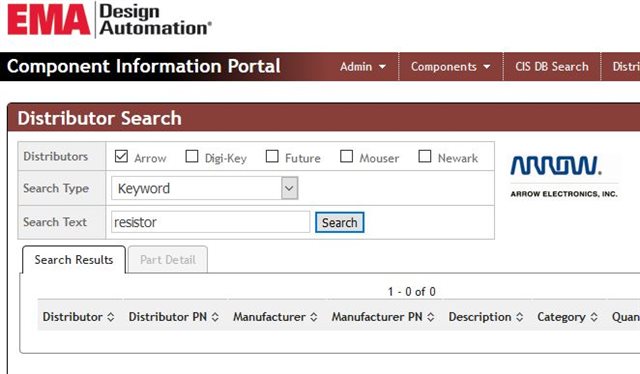

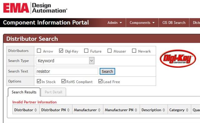

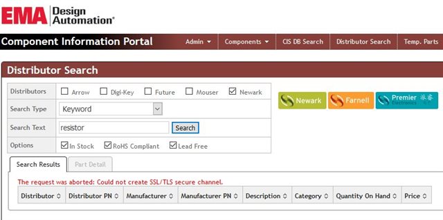

when I try to search in Distributor for some distributors I encounter errors. For digikey the error is "Invalid Partner Information", for Newark "The request was aborted: could not create SSL/TLS secure channel." and Arrow simply does not respond. The CIP version is 4.3. Does anybody some idea?
Below the picture about errors

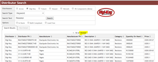

    The current release is 17.2.9.8 as far as I can tell.  I am concerned that you don't have RS Components in your list of distributors (pre 16?)
    When distributors change their API that CIP uses, EMA has to update CIP to maintain the connection.
    If you don't deploy the updates, you have to add new parts manually.

    The response you are getting looks like an old situation where the API had changed.  But, your query of "Resistors" returns results from Digikey on my testbed having 17.2.9.8.

    To some extent, the CIP-E application and the tools version are independent BUT using the latest CIP version with 16.6 will mean that you will be unable to use the "in-tools" plug-in for CIP with Capture CIS 16.6 since it has some 64-bit components, you will need to use the CIP-E web interface for interaction with the CIP-E application, and database, and you will only be able to connect with the data in the database related to the CIP-E application. But, Place>Database Part will still work) You will need to have the latest CIP-E application to have the capability to support the latest API and Distributor endpoints. And, 16.6 was officially "end of life" as of 31st December 2018.
