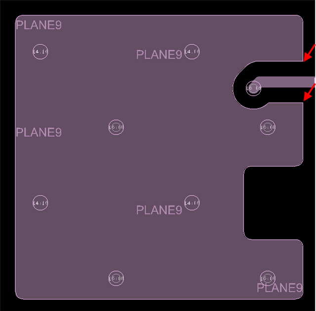

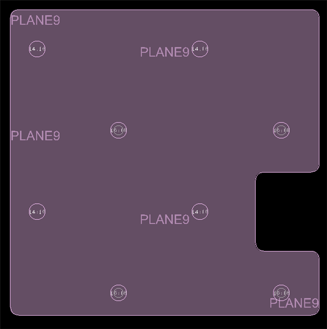

    i was able to make all 4 corners of a rectanglar shape rounded with the tab key.
    but i can not change a few other corners as shown below.
    is there a way to change them rounded?

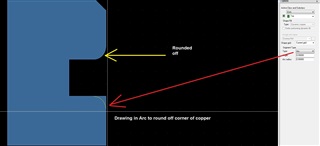

    Hi, it can be done.
    Try Shape > Edit Boundry. Click on the intersection you wish to round off.
    In the options panel change the "Segment Type" to "ARC", You may also want to reduce your grid size when doing this as the arc will be snapping to the grid.
    Draw the arc to round off the corner of the copper shape.
    Here is a picture.
    All the best.

    the corners i am questioning about are created by a notch over the shape because of a cline with a different net as shown below.
    do you know how to change them a rounded corner?

    These are related to the voided part of the shape. You can control this but it may have side effects. Look at Shape - Global Dynamic Parameters (or right click just the shape in question and select Parameters) then Void Controls tab and for acute angle trim control - set this to full round. This will round the corners, you can then adjust the radius using min aperture for gap width. This may be best done on a shape by shape basis rather than on all shapes.
