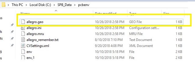

  • steve
    steve over 6 years ago
    Close Allegro, go to your HOME directory, type %HOME% into the address bar of Windows Explorer followed by a return, then descend into the pcbenv folder and delete the allegro.geo file. Then try again.

  • CadAce2K
    CadAce2K over 6 years ago in reply to KobiC
    If you type %HOME% and carriage return in any Explorer (e.g. folder explorer) it will take you to your 'Home' folder. In there you'll find the 'pcbenv' folder as Steve recommended.

  • KobiC
    KobiC over 6 years ago in reply to CadAce2K
    Thanks you both, it worked.
