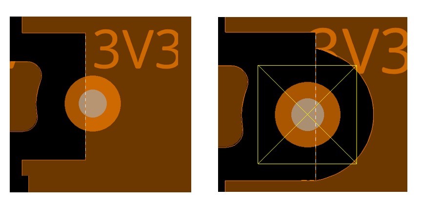

The edge of a via is touching the edge of a same-net shape. The center of the via is not within the shape.
The shape is not voided to remove the small copper sliver. The vias need to have full contact, not thermal ties.
I usually check for these on my designs and adjust the shapes.
I want an automatic shape void or DRC solution.
Thanks

    Hi!
    I'm not sure I understand what you request. The via actually has full contact ... it's just that the red shape is stopped by the green one. Can you make a drawing of what you are expecting?
    Also, when you say this:
    what sliver are you talking about? can you point it out more clearly?

    I asked this question and got no answer. The shape will usually void the via when creating the Gerber artwork.
    Just another bug that has not been fixed.

    Try enabling the Same Net DRC rules for Via / BBVia and see if that helps. They need to be enabled in both CM and Setup - Constraints - Constraint Modes. Once enabled it will void the via if it's causing an issue. The view below shows where the shape boundary is, if it crosses the centre (origin) it covers the shape, if it doesn't it voids it.
